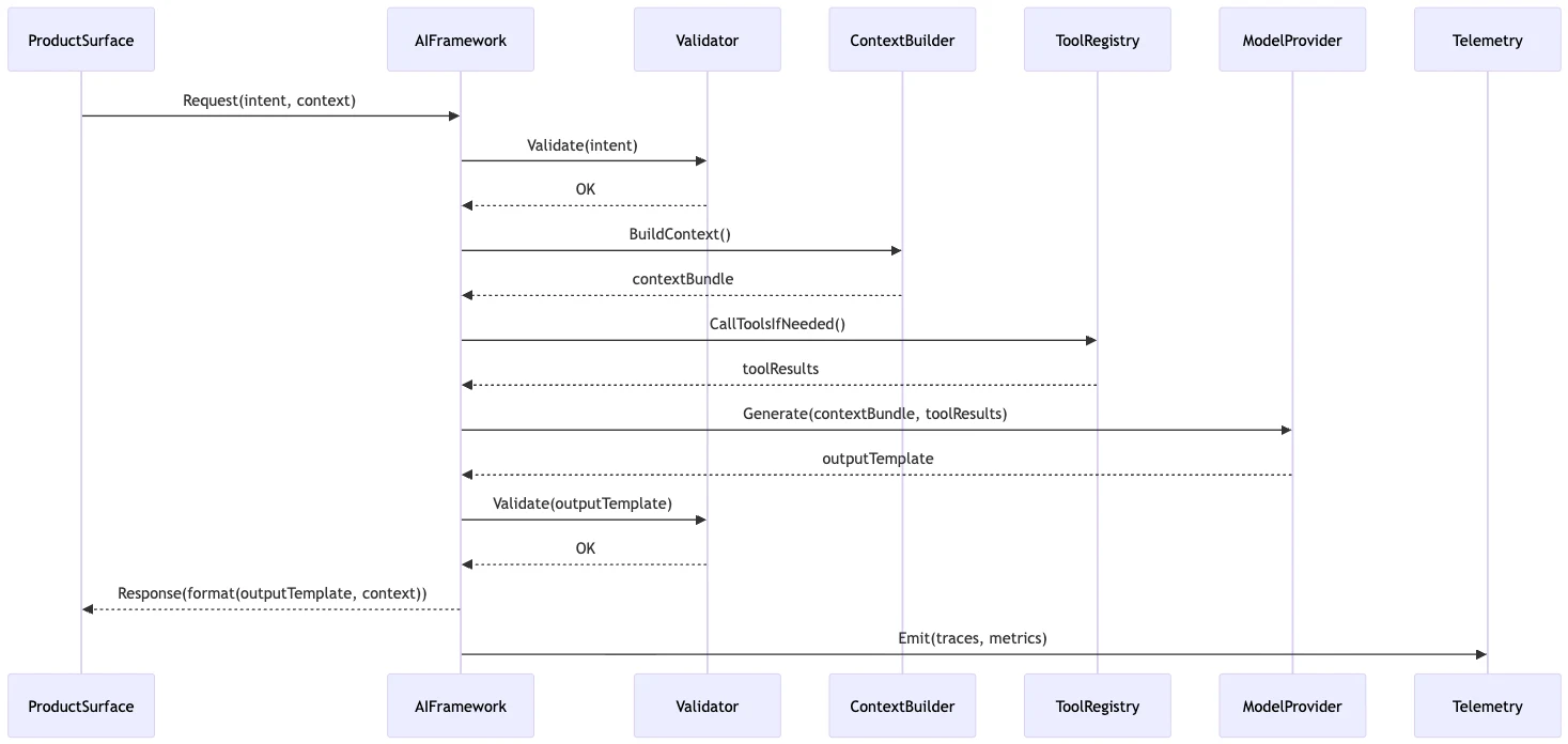

The simplified architecture follows a consistent pattern. Product surfaces send requests with intent and context to an AI framework gateway. That gateway coordinates validation, context building, tool registry access, model provisioning, and telemetry. Each of these components has clear boundaries and responsibilities.
Sequence diagram of a request traversing a simplified architecture between a ProductSurface and an AIFramework. The request intent is validated, context built, tools called, output generated, and telemetry emitted by clearly delineated components.
Sequence diagram for an agentic AI framework designed for scalability
The exact model, separation of concerns, and connection topology matter less than designing for maintainability.  Once there are well-defined boundaries—for example, distinct stages for context building, tool calling, model invocation, validation, and telemetry—teams can ship faster because everyone knows what they're building. Concerns are separated at each component, and the number of potential failure modes is reduced.
